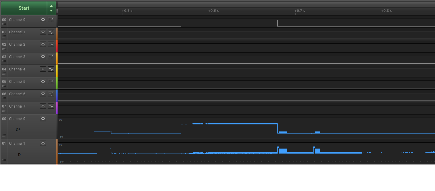

Hi all, i am testing the TPS2546EVM and i'd like to charge and in parallel communicate with a smartphone(Huawei P9). I operate TPS2546 in CDP mode (all ctl pins in high). But the output current doesn't exceed the 600mA (40% battery charge). I'd like to reach 1.5 A as it is the CDP BC1.2 feature. What am I missing?
