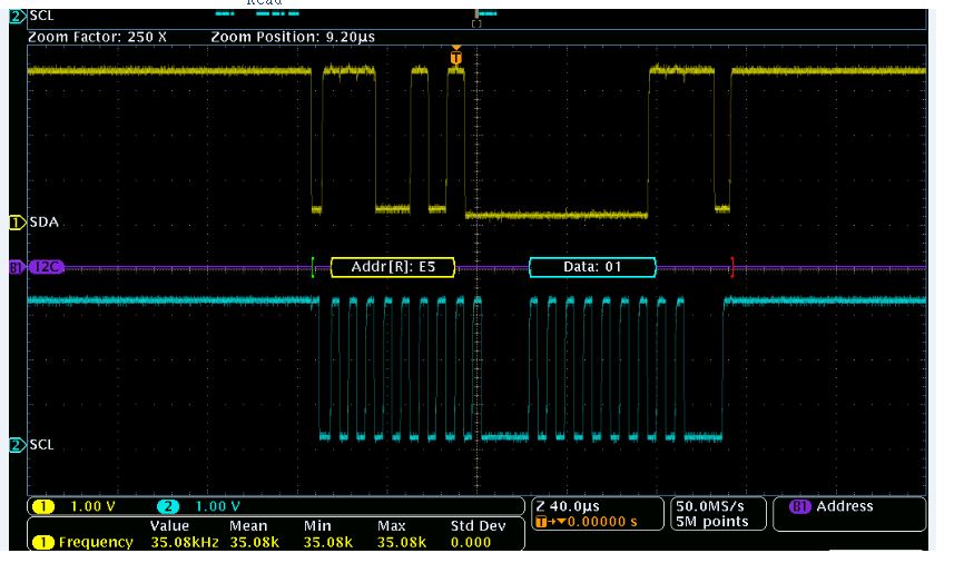

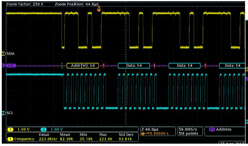

  • Hi Francis,
    We captured the write fail and write/read normal cases.
    For the writes, we can observe the spike at the rising edge both SDA and SCL.
    Cusotmer need to reset PCA9546 to recove the fail situation.
    The write fail is the NACK. Customer need to reset PCA9546A and then can get the ack.
    It is weird behavior. Because the design will reset the PCA9546A at the power up, customer need to reset the PCA9546A again if customer would like to read/write the I2C.
    Could you provide your comment for this NACK issues?
    Here are the waveforms.
    1. write fail case.
    2. write normal case
    3, read normal case

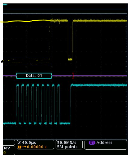

  • Hi Francis,
    The problem is repeatable and consistent.
    As you can see, the slave device do not sen ack at the  9 clock. it happen each time after power up the device. (the PCA9546A will be reset each time after power up.)
    Is this enough info. for you?
    add the VCC power up timing waveform for reference.The VCC rising is very quick.
    SHH

  • Hello SHH,
    Here is an example of what I mean.  Yellow=SDA, Blue= SCL.
    Your customer should know how to do this if they are program I2C devices.
    -Francis Houde
