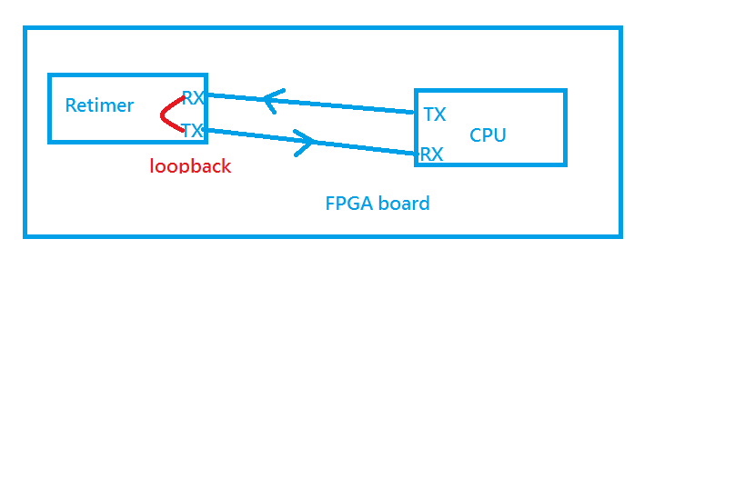

Part Number: DS280DF810
Does our re-timer has loopback mode to support below topology? Thank you.

The DS280DF810 is an 8-channel uni-drectional device. Input data received on a channel Rx will go through EQ stages and then CDR stage before is it output on that channel Tx. The host may bypass the CDR but not the EQ stages. Each channel shares a 2x2 crosspoint with one adjacent channel. Refer to the datasheet for a functional block diagram.
