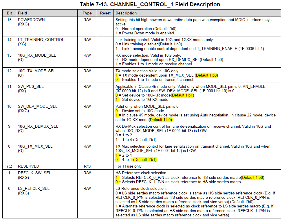

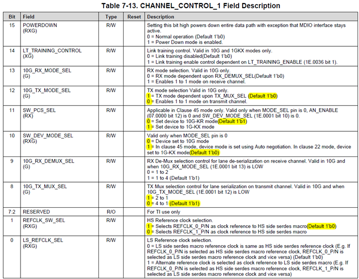

Hi Team,
We would like to know the default value of bit1 of CHANNEL_CONTROL_1.
I am confused in the contents of the data sheet…
I understand that the position of "0" and "1" is a mistake.
If yes, we believe that this default value is “0”(so Selects REFCLK_0_P/N) because “Default 1’b0” is mentioned in datasheet.
Is my understanding correct?

  • Hi Kanemaru,
    The correct values is as follows:
    0 = Selects REFCLK_0 P/N as clock reference to HS side serdes macro(Default 1'b0)
    1 = Selects REFCLK_1 P/N as clock reference to HS side serdes macro
    I've requested this change in datasheet.

  • Hi Luis-san,
    I have one more question.
    I found some similar mistakes and understand that “Default 1’b x” is correct information.
    And, could you revise these contents in the datasheet?
    Kanemaru
  • Hi Kanemaru,
    Good catch! Please let me verify with the team, in my understanding we need to change these values since this device was leveraged in the TLK10232. If so, I will request these changes in datasheet ASAP.

  • Hi Luis-san,
    I have additional questions.
    [Q1]
    I would like to know the truth default value of the following resisters.
    -10G_TX_MODE_SEL(G)
    -SW_PCS_SEL(RX)
    -SW_DEV_MODE_SEL(RXG)
    -10G_TX_MUX_SEL(G)
    -REFCLK_SW_SEL(RXG) (I understand that default values is “1’b0” so “Selects REFCLK_0_P/N as clock reference to HS side serdes macro”)
    [Q2]
    Based on [Q1], please let me ask a question again.
    is there the modification in your past answer?
    https://e2e.ti.com/support/interface/high_speed_interface/f/138/p/605953/2240118#pi239031350=1
    <Your past answer>
    If the customer is going to use 10GBASE-KR mode, they just need to change the HS_PLL_MULT[3:0] to '1100' (x16.5),
    in this case the device is going to perform Auto-Negotiation and Link Training, if the these featured are no needed please disable them.
    Kanemaru
  • Hi Kanemaru,
    A1. We need to modify the default values for these registers since there is a swapping error. Hence the correct default values are as follows:
    10G_TX_MODE_SEL
    0 = TX mod dependen upon TX_MUX_SEL (Default 1b'0)
    1 = Enables 1 to 1 mode on transmit channel.
    SW_PCS_SEL
    1 = Set the device to 10GBASE-KR mode (Defaul 1b'1)
    0 = Set the device to 1G-KX mode
    SW_DEV_MODE_SEL
    1 = Device SET TO 10G mode
    0 =  In clase 45 mode, device mode is set using Auto-Negotiation. In Clause 22 mode, device is set to 1G-KX mode (Default 1b'0).
    10G_TX_MUX_SEL
    0 = 2 to 1
    1 = 4 to 1 (Default 1b'1)
    REFCLK_SW_SEL
    0 = Selects REFCLK_0_P/N as clock reference (Default 1b'0).
    1 = Selects REFCLK_1_P/N as clock reference.
    Note. Please take the TLK10232 datasheet as reference for default values registers.
