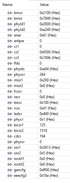

    Can you provide a register dump of registers 0x0h to 0x1Fh?
    The IC you have is the same as on the EVM, no difference.
    Ross
  • COL is strapped to Mode 3.
    A list of the registers' information is shown as the attached file below.
  • Hi Yaoting,
    The bootstrap for RX_DV is probably your issue here. The pin is strapped for MODE2, which is a violation.
    You need to have it in MODE 1 for MII operation. Please add an external pull-down since it appears your connected MAC is pulling the pin high.
    Also, a few of your other pins are oddly in MODE 2 as well: RX_D[3:0]
    Ross

  • Hi Ross,
    After we add the pull down resistors we can get correct values from bootstrap registers (0x467 and 0x468)  which show that, the 0x467=0803h and 0x468=0000h. The circuit is working now. But, i still have questions for you,
    1) the BMCR register(0x000) equals to 3100h, that shows the bit12 = "1". It means the Auto-negotiation is enabled and it says this bit is related to Strap. My questions is, which strap setting will affect this setting? In FX working mode, should we allow the auto-negotiation?
    2) the BMSR register(0x001) equals to 7849h. It shows bit3 ="1". it means "Device is able to perform Auto-Negotiation". Is it related to above question? Also, the bit2="0". It shows link is not established. but actually, we can communicate over the link, why?
    Looking forward to your answers.Thank you for your helps.
