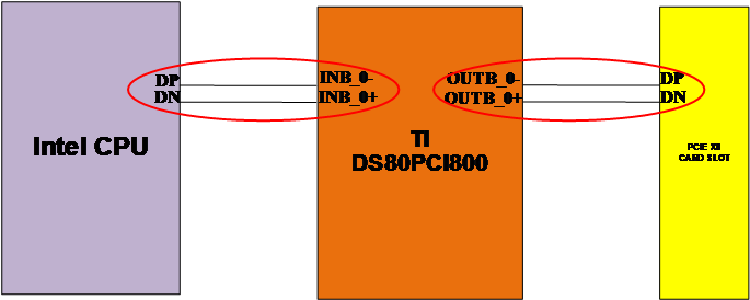

Part Number: DS80PCI800
Hi Team,
Customer woule like to use DS80PCI800 for robotic application.
Coudl you please help review the shematic?

Hi SHH
I suggest to use RATE = Float
R668 and R672 for address B6 should be DNI.

Hi SHH,
I would have an option to connect the PRSNT_N pin to the system PRSNT signal so the DS80PCI800 can better support hot-plug events if necessary. Otherwise the schematics look okay.
In the future it would be okay to email the schematics if needed to protect any confidential docs.
