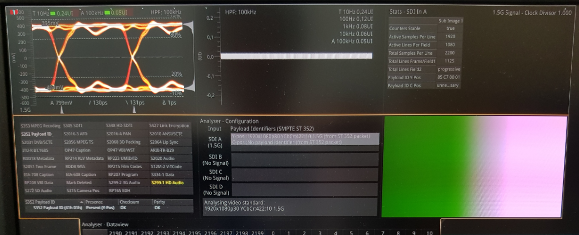

I am using LMH1218 and XilinX Kintex 7.
I measured  eye and jitter using Phabrix Qx.
Signal quality was OK and Video was shown on Phabrix Qx.
But on mormal sdi monitor, video was not shown. I tried several different monitors.
I attached measured data on phabrix qx.
Thanks.

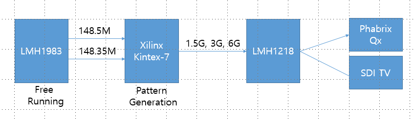

  • Hi Michael,
    1. This is the block diagram
    2. I am not using EVM.
    3. Pattern is just linear Pattern. Y and C is the same from 0x001 ~ 0x3BC.
      SDI Output is YCbCr 4:2:2 10bit.
      So Do I need to limit data within range (0x004 ~ 0x3FB)?
    4. I tried 1.5G, 3G Level A and 6G.  All data rates are not working.
    Thanks.
  • Hi Randy,
    Thanks for the information. Based on your feedback, it seems like perhaps there is a data formatting incompatibility between the FPGA and monitor. Since the Phabrix Qx is able to display a video output and identify incoming data, this implies to me that there is no issue with the LMH1218 driving out the data. The LMH1218 is a simple physical device and does not process the incoming signal beyond analog signal conditioning.
    I have a few thoughts about diagnosing this issue:
    1. Can you replicate the same pattern, resolution, and data formatting within the Qx, and use the Qx generator output as the source to the SDI monitor? I am curious about whether the Phabrix Qx is able to display an output on the SDI monitor if the format is the same as what Kintex is currently outputting.
    2. If there is a pattern and data formatting from the Phabrix Qx that works with the SDI monitor, please try matching the formatting coming from the Kintex-7 so that it is the same as the Qx. From there, see if the output from the LMH1218 is recognizable by the SDI monitor.
    Michael
  • Hi Michael,
    Phabrix Qx doesn't have custom pattern generation. It has only internal fixed patterns.
    I fixed this issue by limiting pattern data values between 0x004~0x3FB.
