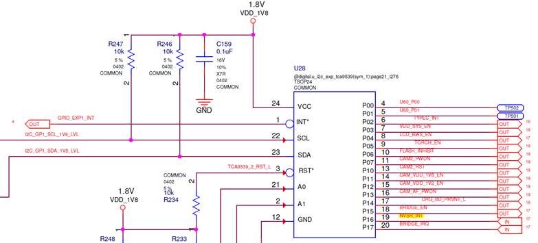

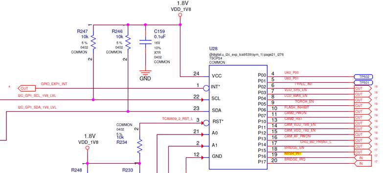

  • Hi Sirs,
    Thanks for your reply.
    Our schematic as below
    We need confirm one thing.
    Our Pin 16 is connect ”NVSR_INT” input
    If Pin 16 have change different state then TCA9539 will proactive notification our system, right?
  • Hello Shu-cheng,
    Where is the pull up resistor on the INT pin? You need that because the INT pin is open drain and that is the only way you can tell if it is logic high or low. High is pullup with FET OFF and low when INT is activated (in other words FET is turned on and pulled low).
    Assuming you have an pullup on the INT pin than yes, the TCA9539 will notify you (the master) that you have a state change on any of the input pins of the TCA9539.
