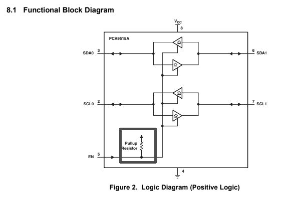

PCA9515B: EN pull-up resistor
Part Number: PCA9515B
How many resistance value is pull up resistor of EN?
Kuramochi
  • Hello TQ,
    I wished that this datasheet had put the resistance value range, but you have to do a couple of steps to figure out what the range of the value is.
    For the typical value, we know that the voltage is either 2.5 or 3.3V, therefore Vcc=2.5 or 3.3V.
    Here is the calculations.
    So the range is 115k to 310 k Ohms.
    -Francis Houde
  • Hello TQ,
    After investigating further I found it was done at 3.3V only.  Thus:
    Let me know if you have any questions.
    -Francis Houde
