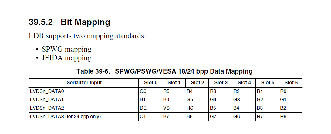

There just be two (2) unused bits in 18-bit (666).
What is critical here is what the mapping of the panel requires.

Using the DS90CF366 to convert LVDS signal from FreeScale imx6 Dual/Quad to RGB display.
Currently I have question about the RGB Signal mapping from DS90CF366 to display connector (using SPWG/VESA/PSWG)
Please help me to check the signal if i have bit mapping correctly.
Attached the schematic for the TI-deserializer and bit mapping of the LVDS signals from FreeScale imx6 Dual/Quad .
I have considered R0 and B0 as unused pins and i have grounded them in design.
