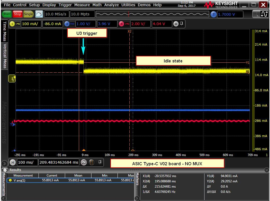

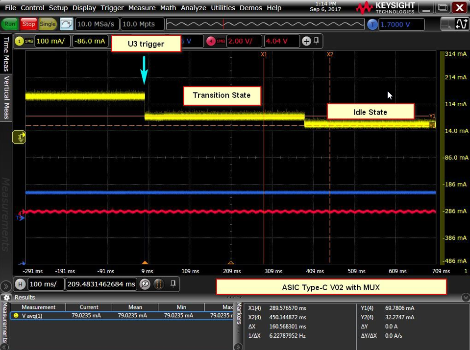

according to data sheet "Delay from U0 to electrical idle" should be 6ns typical
on our measurements we see that it takes the TUSB542 about 400ms from U3 to enter the low power state
(we repeat the test with and without the TUSB542 and this was the difference)
this is way longer then what the USB spec requires
can we do something to improve it?
