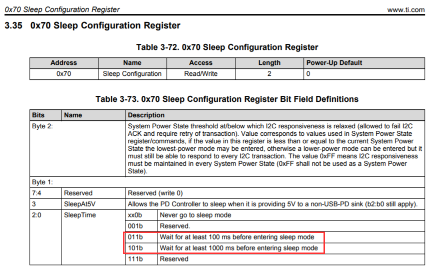

    2. In sleep mode, I2C First Transaction Fail then wake
    What is the delay time from I2C First Transaction to wake?
    (The customer is asking available time of I2C read/write)
    The delay time can be configured for either 100ms or 1s, by writing to the sleep configuration register (screenshot below). The table below can be found in the TPS65981/2/6 Host interface technical reference manual: http://www.ti.com/lit/ug/slvuan1a/slvuan1a.pdf
