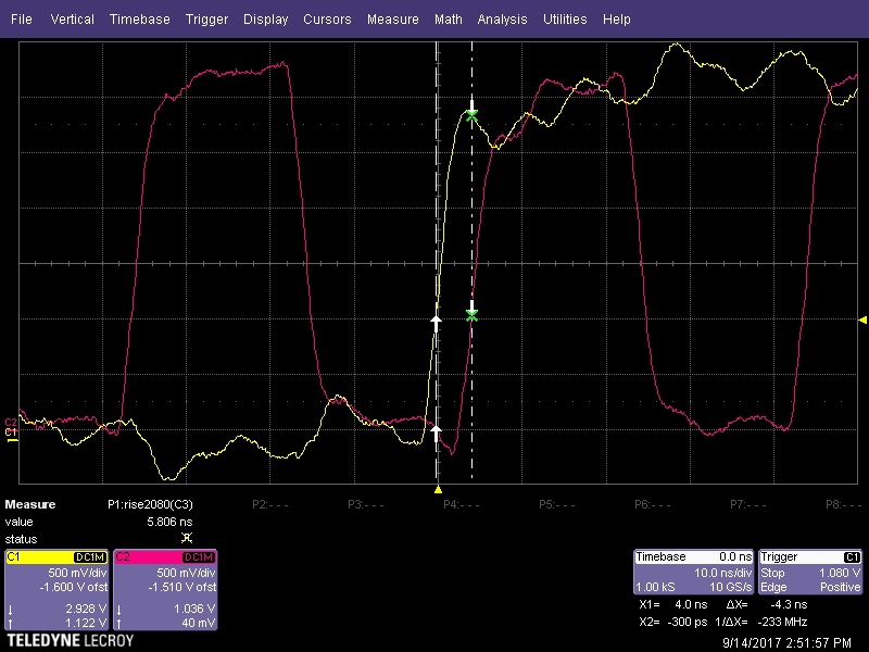

  • Hi Patrick,
    Is there any way you can provide a schematic as well?
    Thank you for attaching the register dump! Where do you want to implement the clock delay for RGMII interface?
    Do you want delay included within the MAC or the PHY? How you currently have it is delay for transmit path but not the receive path.
    Do you mind providing a screen capture of the setup/hold time at the TX pins of the PHY and at the RX pins of the MAC?
    Can you also probe the XI pin and show me the reference clock? I am curious if this is a crystal stability issue.
    Ross

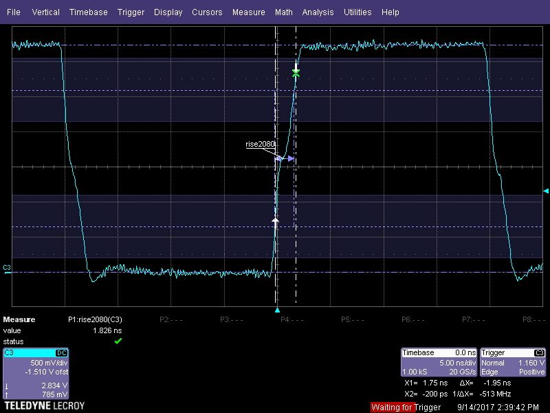

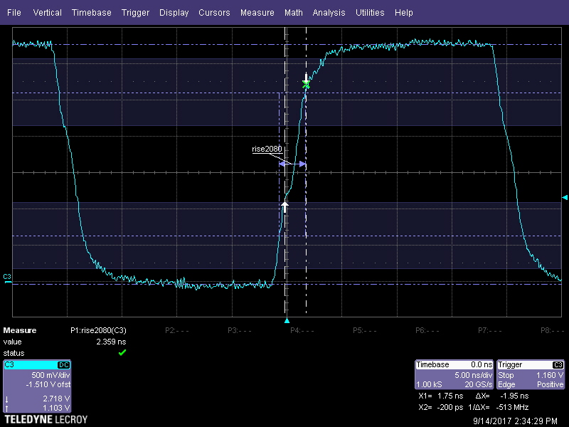

  • Hi Patrick,
    I just reviewed your schematic and waveforms.
    Please populate the pull-down on LED_1. This is a requirement for LED pins (it is not related to the RGMII though).
    The schematic looks good to me, however, can you please change the series termination resistors on your board to 0 ohm and re-take the waveform images?
    Also, do you have the ability to enable internal delay within your AM5728?
    Ross
  • Hi Ross,
    Thank you for your suggestion.
    We have replaced the resistors on the receive path to 0 Ohm, the 20/80 timing seems to slightly increase the rise time, nevertheless it is now around 1.95 ns, where we see some reflection.
    On the receiving side I still have the same amount of frames being dropped.
    Tomorrow we will modify the receive delay. I will keep you up to date.
