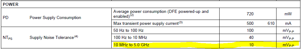

DS125DF410: 2.5V power noise tolerance
Part Number: DS125DF410
Hi team,
DS125DF410 datasheet denoted noise tolerance for 2.5V power as below:
now my customer would like to know that :
1. is this supply Noise tolerance meant 2.5V power ripple noise?
2. is the 2.5V power ripple noise must below 10mV at corresponding frequency?
