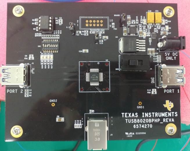

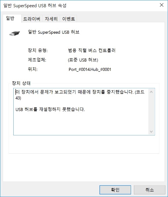

TUSB8020BEVM is happened error code 43 when device driver installed.
My TUSB8020BEVM video file.

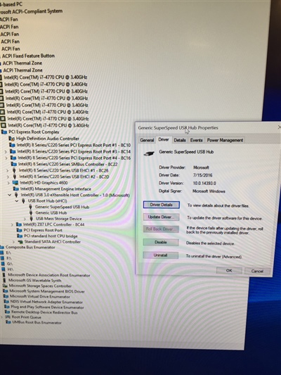

Hello Kiyoung,
USB 3 / USB 2 drivers are loading for TUSB8020B on my Win 10 setup without any issues. I did notice that there were some issues reported online with this particular USB driver 3 update and some users needed to disable the XHCI controller and let it get rediscovered on reboot. Can you confirm if the TUSB8020B works on other systems?
Hi Kiyoung,
Thank you for providing the photo, I am using the same board with the same settings and I'm not able to see the error. Can you confirm if the board works normally on non-Win10 machines? Also, if you try to uninstall and reinstall the driver does it fix the Code 43.
