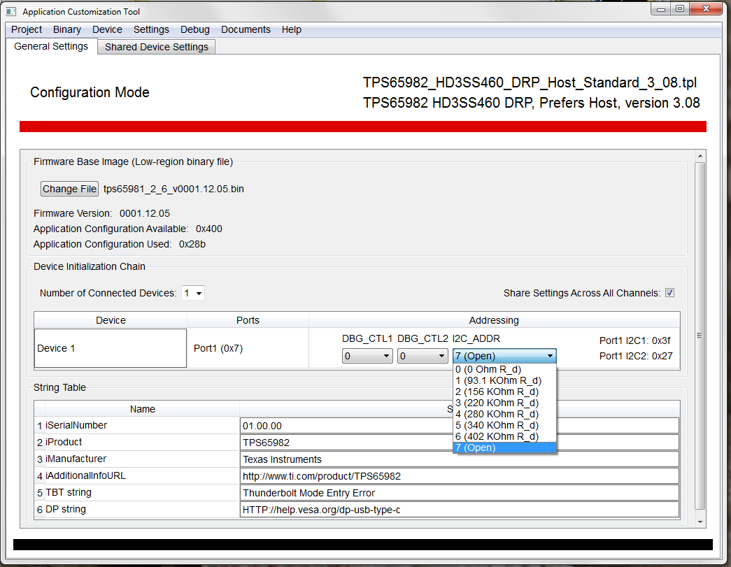

I am running into trouble with the new version of the configuration tool, specifically with the "debug mode" The device is configured and works with the address 0x27 when the Aardvark is used manually and through the utilities GUI, but with the debug mode it seems to be cycling between address 0x20 and 0x38. How can I tell it to use address 0x27? it will not connect otherwise.

  • Hi Saqib,
    In order to change the I2C address that the debugger will connect on, please change the pin strapping in the "Device Initialization Chain" section on the "General Settings tab" as shown below.  As you change the DBG_CTL1/2 and I2C_ADDR values, you will see the effect on the I2C1 and I2C2 port addresses.  These are pins on the TPS6598x device that can be pulled to 3.3V or Ground (for the DBG_CTL) or strapped with a resistor value (I2C_ADDR).
    If you set I2C_ADDR to "7 (open)" it should give you the address you are looking for.
