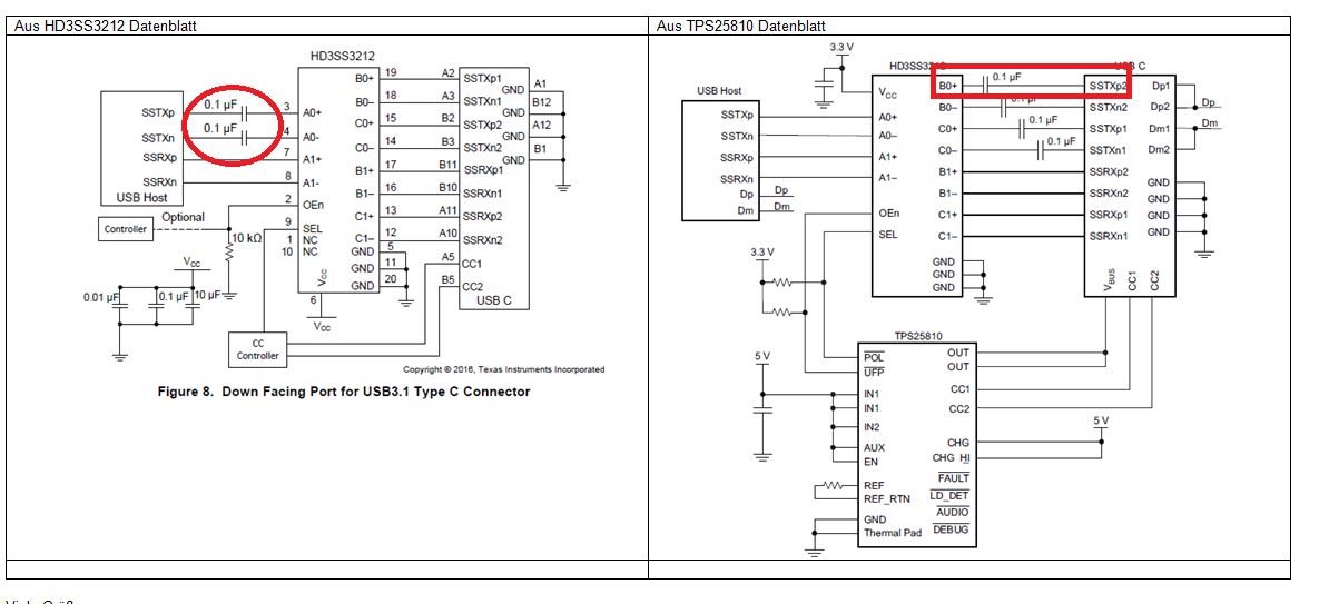

for our Starter Kit for the i.MX8X from NXP, we want to implement a USB Type-C solution:
• Standard Type-C without power delivery
• Pmax 15 W, only 5 V
• USB 3.1 Gen1 signals including USB 2.0
For this I want to use TI controller and switch: TPS25810 and HD3SS3212
There are different circuits in the two data sheets:
• Serial capacitors between host and switch OR between connector and switch?
• Connection switch to connector different (see B0 + on pin SSTXp1 or SSTXp2)?
What is the recommendation of TI?
