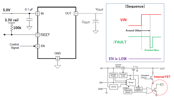

Our customer is evaluating TPS2065D at the condition.
Then, /FAULT pin is pulled down to LOW during around 50us when VIN is applied and EN is LOW.
I guess that the internal FET of FAULT is turned ON when VIN is applied.
Is this correct behavior?
[Conditions]
-VIN is 5.0V
-/FAULT pin connect to "3.3V rail (other than VIN)".
