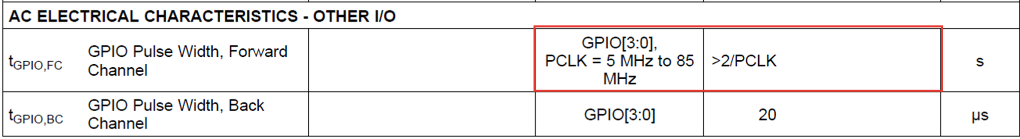

- 1 - . To use forward channel GPIO.
If user will use video data,  we can use GPIO.
According to datasheet, min pulse width depends on Pixel clock.
For example, when PWM frequency is 3 MHz w/ duty 50%, then pulse width is 166ns.
In this case, it is no problem as long as Pixel clock is over 12MHz.
However, I'm not sure when there is no video data, user can send GPIO on forward channel to deserializer or not.

    Yes, even when no video data is tranmitted, GPIO data is still sent continuously across forward channel when the serializer and deserializer have valid lock status.
    I would not recommned to use I2S for PWM clock signal.
