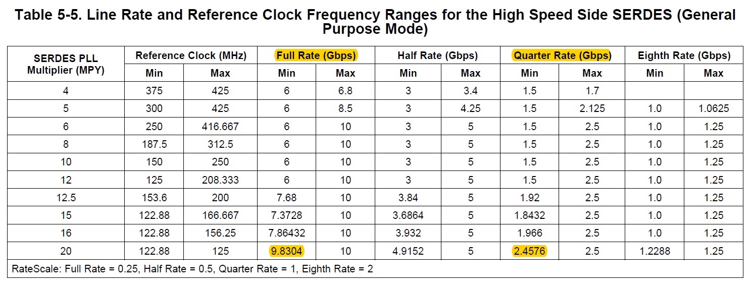

Could TLK10232 channel A set to 9.8304G and channel B set to 2.4576G (independent)
  • Hello Hsiao,
    Yes, every channel is able to operate at different data rate. Channel A and B are fully independent and their application rates and references clocks are separate.

    Could you provide register address for config
    1. RateScale Register for channel A
    2. RateScale Register for channel B
    3. PLL multiplier Register for channel A
    4. PLL multiplier Register for channel B
  • Hi Hsiao,
    Channel A
    Data Rate = 9.8304Gbps / REFCLK = 122.8 - 125Mhz /Full Rate
    HS_PLL_MULT[3:0] ==> 1101 (x20)
    HS_RATE_TX[1:0] ==> 00
    HS_RATE_RX[2:0] ==> 000
    Channel B
    Data Rate = 2.4576Gbps / REFCLK = 122.8 - 125Mhz /Quarter Rate
    HS_RATE_RX[2:0] ==> 110
