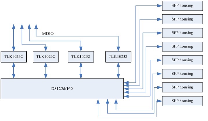

May I use DS125DF1610 for below structure ?
Yes. The DS125DF1610 is well suited for port-side optical applications. You may refer to the TI applicaiton note per the link below for additional guidance.
