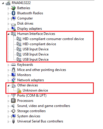

Our TUSB3210 will be unknow device on system device manager.

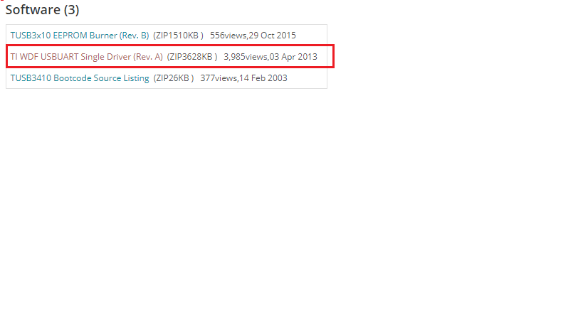

We have install TUSB3410 Single driver but still unknow device

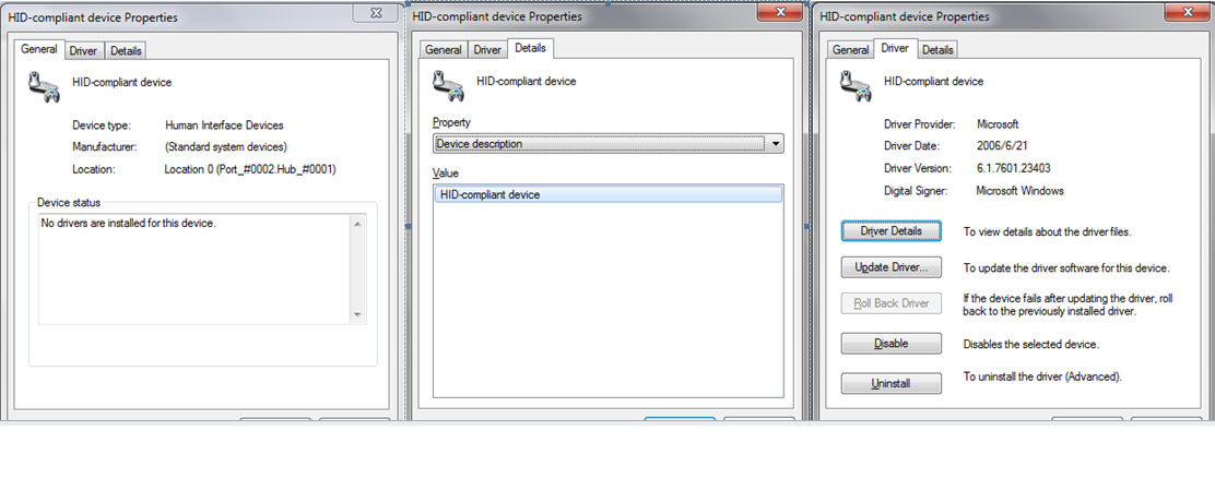

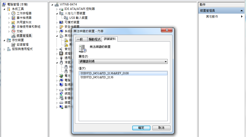

    Please provide a screenshot showing the device's "Hardware ID" on Device Manager
    Do you mean this?
  • Hi Sirs,
    Update pic as below
  • Shu-Cheng,
    The TUSB3210 is a General purpose USB controller. You will need to develop a firmware to define the behavior/interface of your device, and the firmware must be programmed to an external EEPROM that should be connected to the TUSB3210 through the I2C interface.
    The TUSB3410 USBUART driver is not intended for this device.

  • Shu-Cheng,
    When the TUSB3210 is plugged-in over USB, the bootcode (which is stored on the device's internal ROM) will try to get your firmware from the external EEPROM. If there is no EEPROM, or if the data on the EEPROM is not valid, it will enumerate a USB interface (VID_0451&PID_2136) that would let you program the external EEPROM with your firmware over USB (This can be done using the TUSB3x10 EEPROM Burner - www.ti.com/.../sllc443).
    So what you are seeing when connecting the device is precisely that interface. You still need to develop your firmware (and program that on the external EEPROM) so you can manipulate the GPIOs and perform any other tasks you may need.
