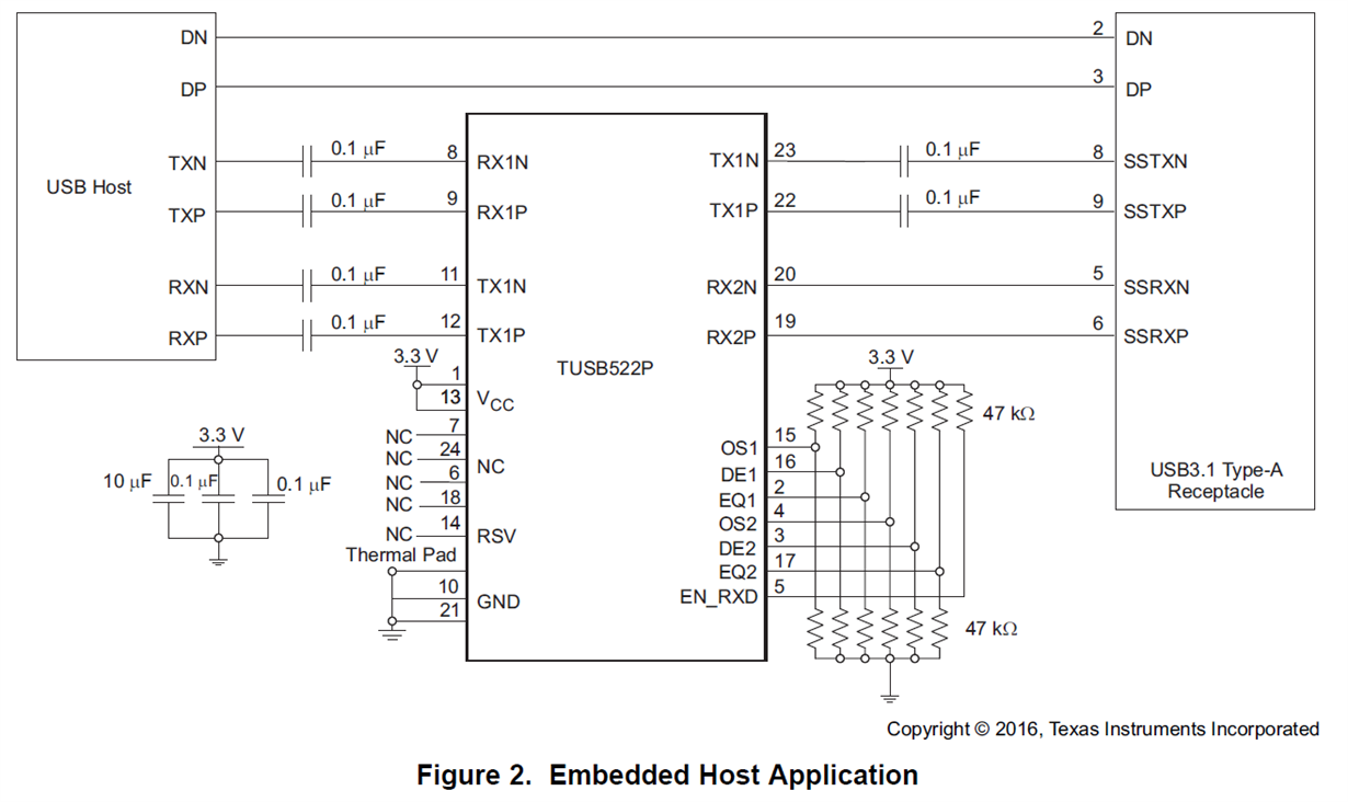

Dear Specialists,
My customer would like to confirm direction of the connection.
I would grateful if you could advise.
According to the datasheet P.11 Figure 2., RX1N(8pin), RX1P(9pin), TX1N(11pin) and TX1P are connected to Host side.
On the other hand, EVM schematic is opposite,   RX1N(8pin), RX1P(9pin), TX1N(11pin) and TX1P are connected to device side.
Is it possible to connect either case?
Which is recommeded?
Is there any limitation?
I appreciate your great help in advance.
