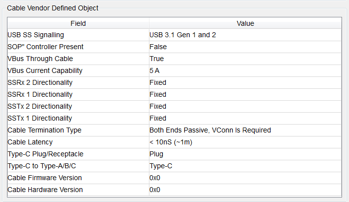

  • Hi Praneet-san,
    My customer would like to make sure that the cable which passes compliance test is attached. And in order to surely know the identity of the cable, they think that it is necessary to know the communication result of Cable VDO.
    Is the communication result stored somewhere in the device?
    Takashi Onawa
  • Takashi San,
    My question(s) from the previous post is not yet answered - Hope my response answered the customer's queries.
    0x49 will hold the response 'Discover Identity Response' from SOP' - Refer Page-46 of the TRM document (@ www.ti.com/.../slvuan1a.pdf) for more details.
    -/Praneet
  • Hi Kumar-san,
    Sorry, I forgot to answer your question.
    They want to distinguish bad cables which has built-in dummy Ra but no eMarker IC integrated. they  think that all eMarker cable should expose Ra for Vconn power supply but it's not enough to distinguish such the bad cable because Ra only presents if the cable needs Vconn or not.
    On the other hand, Type-C spec says as followings, so "Discover Identity" response from the cable should be the criterion for judgment.
    "Electronically marked cables shall support USB Power Delivery Structured VDM Discover Identity command directed to SOP’."
    Anyway, I could get the Cable VDO information from RX Identify SOPp register(0x49) as below.
    Thanks for your support.
