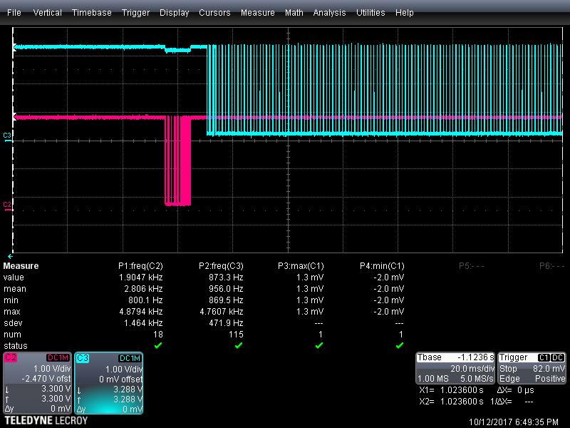

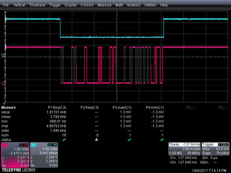

We used SN65HVD1780 as the RS485 line driver in our product .While measuring the R and D wave form we found the below observation.
The R signal which is the receive signal (TTL) is having a dip when the D (transmit) signal is active . The R signal which is usually high when idle will have pulses when it is receiving .
During the reception the signal is ok and there is no Dip observed in the D line (transmit)
Please see the below graphs
Blue is R and red is D. please clarify why such a dip is observed in the R signal
Eby
  • Hi Eby,
    I've tried to understand your problem and so far I still need some info from your side. As a matter of fact I would like to know if you are connecting both  DE pin and RE# pin. Could you provide values or measurements of those pins?
    When RE# is logic low the receiver is enabled but in order to send data, DE must be logic high in order to be in driver mode.
    The R pin dipping almost at half dynamic could be caused by different sources driving that node, so as a first suggestion I would try to see if by inserting a pull-up resistor onto the R pin could be helpful. This would keep the R pin high during the receiver disabled phase, as R shows a high impedance at this point.
    Looking forward to your inputs.
    Adrian

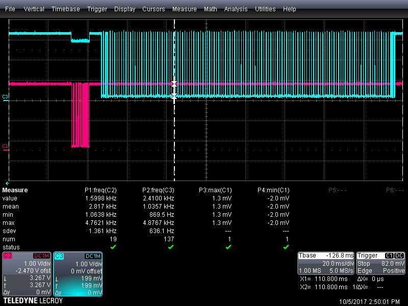

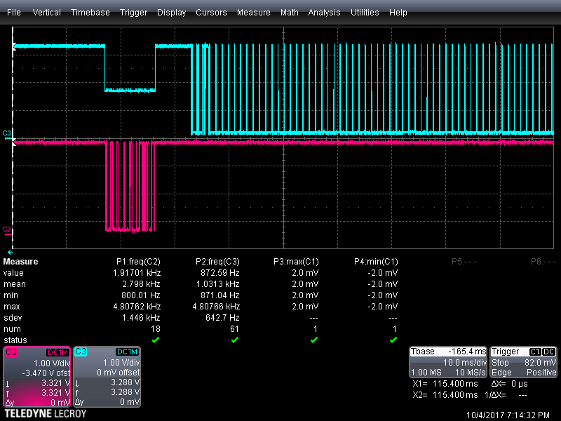

  • HI Adrian,
    The waveform with 10K pull up on the R line shared below . We have seen the Dip with Different processors interfaced with the same RS485 chip.
  • Hi Eby,
    have you tried different values of pull-up resistors? Even in that case do you still see the same dip?

  •  HI
    Please find the graph with 3.3K pull up on R line
  • Hi Eby,
    so with a smaller pull-up resistor you measure a smaller dip.
    To me it seems that something is pulling down that node. Probably some leakage current. Could you tell me if there is anything else on the R pin node? Maybe show part of the schematic that is specifically showing everything connected to that node. Maybe a protection diode leaking current? If that's sensitive for you, we could discuss about this via email.

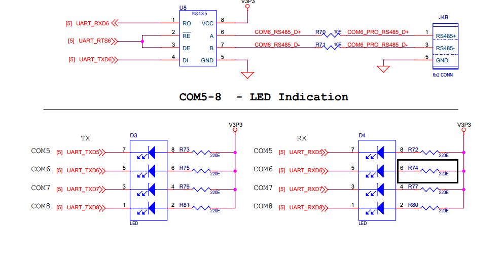

  • Hi Adrian,
    Yes , the dip is there with a different Micro controller also .

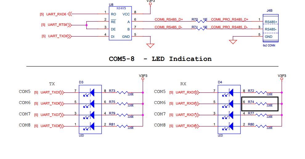

    There is one more observation. There is a an LED indication from this pin, i tried removing the resistor and found that the DIP was even worse. R74 was removed and found that the DIP was even worse
    Eby
  • Hi Eby,
    thank you for sharing this part of the circuitry. Yes, the R74 is working in this case as a pull up resistor for the LED and as a current limiter. When the RXD6 pin goes low, the LED is turned on and vice-versa when RXD6 is high the LED is off. By taking off the R74, you lose the ability to pull up that node towards V3P3. This is manifested in an increased dip at the R pin.
    Have you done any testing on the other resistors too? For my knowledge the same behavior should happen also to RXD5, RXD7, RXD8.
    This is still proving the fact that the R pin (RXD6) shows some leakage.
    Please let me know if you have any other info.
    Adrian
  • Hi Adrian,
    I had tried removing all the resistors and the behavior is the same for RX5-RX8 lines .
    Yes I understand that the Resistor is acting as a pull up .
     So if we didn't had a pull up , it would have been worse i guess.
     One this we noticed is that ,if we don't have the pull up and the LED-Resistor combo , there was unwanted junk characters received at the node even if no source is connected to it .
    Is there anything else that we can check from our side on this circuit .
    Eby

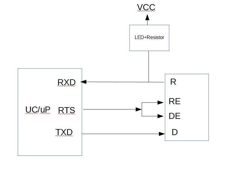

  • Hi Eby,
    (Adrian is out of the office this week, so I will try to fill in.)
    I think this portion is well understood, but just to be totally clear - the voltage level on the R output is expected to be different depending on whether the receiver is enabled or not (i.e., whether the /RE pin is high or low). When the receiver is enabled, the output is driven via a low output impedance and will be either close to the VCC supply or close to the transceiver's ground. When the receiver is disabled, the R output is high impedance and thus the voltage will "float." This means that it will not be strongly biased to any particular voltage, and so its value will depend on whether it is pulled high or low externally, what kind of loading is present, etc.
    It looks like in this case using the pull-up resistance is effective in ensuring a high logic level on the R output while the receiver is enabled. If you are concerned about the voltage being lower than you would expect, though, then it would be important to understand what may be sinking leakage current from this voltage node.
    What connects to this node? From this thread it sounds like there are just a few things: the transceiver output, a pull-up resistor, an LED indicator, and a logic input to a microcontroller. Is there anything else? If not, then most likely the leakage currents would come from either the MCU, the transceiver, the PCB, or the oscilloscope probe used in this measurement. (By the way, what is the input impedance of this scope probe?). You could see which component is having the strongest effect by removing them and seeing if the measured voltage increases. For example, if you removed the transceiver and measured the voltage on the "R" line (using the same measurement set-up), I would expect you to measure the same voltage as during these periods when the receiver is disabled (since in that state we expect the receiver output to sink or source less than 1 uA). If you saw a much higher voltage, though, then we would know that the lower voltage is somehow related to the transceiver.
    I hope this makes sense - please let me know what further questions you have.
    Max
  • HI Max
    Thanks for your reply ,
    One thing  is that the Dip in the R is only noticed when then the RS485 chip is transmitting. On other situation like when there is no transmit and receive there is no Dip noticed
    The issue is not observed when the Receiver is enabled . The issue is actually observed when the Driver is enabled .
    The R is dipping when the Driver is enabled and when the receiver is enabled the R signal is OK.
    Yes we want to know the node which is sinking this current .
    This is a basic block level representation of the interface .
    We are measuring the Waveform with the DC-1Mohm mode
    We will check the signal with the transceiver removed and will update you the status of the same
    Eby
  • HI Max,
    I tried removing the transceiver and measured the waveform.
    Now what I observed is that the R line measures 1.6V continuously which was the amount of DIP we measured with the transceiver.
    So from the test I understand that the issue is not with the transceiver and something is having an impact from the rest of the circuit .
    To confirm that is was not the issue with the DSO I measured it with the Multi-meter
    So the source is from the Board may be the processor Pin might be pulling it down .
    And I guess the Pull up resistor addition on the R value or adding a buffer or something will make a difference .
    Thanks for the support
    Eby
  • Eby,
    Thanks for following up with this information, and I'm glad you are getting closer to discovering the root cause. It sounds like it's probably worth checking into the input resistance of the processor's input next to see if it might be the source of pull-down current.
    I'm not sure what else we could assist with if the issue is not related to the transceiver device, but please continue to feel free to contact us if you feel there is any help we can provide.
    Max
