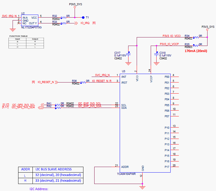

Customer connect ADDR as below to set I2C slave address as 0x20.

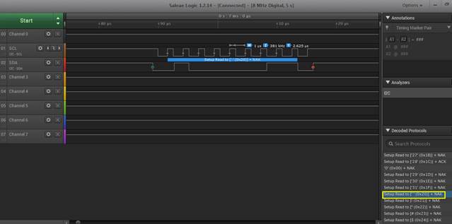

And they tried to access the chip using 0x20 , but no ACK is responded from the chip as below.
THey confirm RESET is correctly at 3.3V during the test and other I2C devices on their board can respond correctly to the I2C host on their board under the same test scenario (with other I2C slave address.)  Please suggest what else we can check to clarify this.

    1) Are the P0-P7 and P10-P17 connected to anything or are they floating? The current into VCCP seems a bit high especially if they are floating.
    2) Have you checked the voltage levels at VCCI and VCCP when the part is turned on and you are sending the address? What do the voltages read?
    3) Is it possible for us to take a look at the PCB layout? I just want to be sure something funny like SDA and SCL aren't swapped.
    4) Can we get an O-scope waveform of the SCL and SDA lines? The logical analyzer does not show us the rise or fall times and there may be something unexpected on the lines which isn't seen by the logic analyzer.
    The addressing pin looks correct. With it pulled to GND you should be trying to access 0x20.
    I've checked the schematic pin mapping to the datasheet's pin mapping, the two match up.
    The device marking of PH416A correlates with the datasheet.
    -Bobby

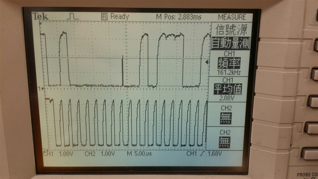

    Below shows some SDA/SCL oscilloscope shot while their scan tool is working.  (We can't trigger the waveform to stop at the moment is access 0x20.)  Please check them for a reference regarding the rise/fall time.
    Do you think it's related to the external pull-up resistor value?  Why it can work well after the access from Aardvark ?

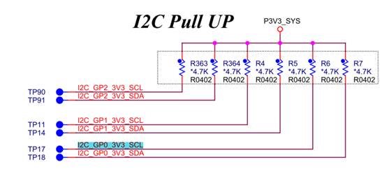

    3. On the daughter card, there's a external pull-up 4.7kohm as below.
    4. The I2C waveform provided earlier is captured with both 4.7kohm (R4/R5) and 10kohm (R3323/R3325) implemented.

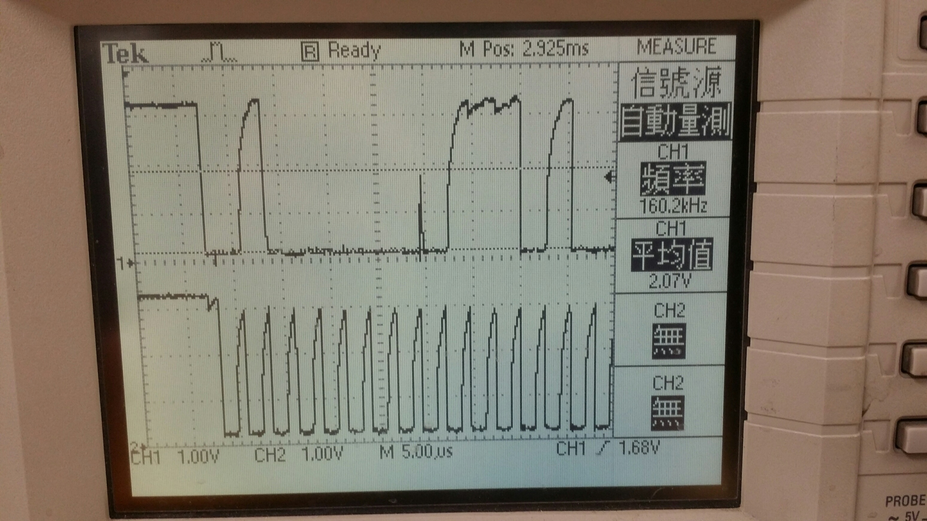

    5. The waveform as below is captured with R4/R5 open.  Only R3323/R3325 (10kohm) is implemented.  We can see ACK fro TCA6416A while is access 0x20 (slave address of TCA6416A), but their scan tool still can't detect TCA6416A correctly.
      6.The waveform as below is captured with R4/R5 open, and R3323/R3325 are changed to 4.7kohm.  We can see ACK fro TCA6416A while is access 0x20 (slave address of TCA6416A), but their scan tool still can't detect TCA6416A correctly.

  • Hey Anthony,
    The waveforms from the second post ( Oct 5, 2017) and your latest ones don't match up. In your second post, the address sent is not 20xh but 03xh. Are you sure the scanner is sending the correct address or did you upload the wrong picture in the second post?
    Also to clarify, is your Aardvark going through the PCA9306 (connected to pins 3 and 4 of PCA9306) or is it connected after it (pins 5 and 6 of PCA9306)?
    Judging from the waveforms, the pull up resistors are not the issue. They seem to reach 0.7*Vcc in time to be sampled.
    -Bobby
