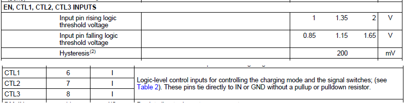

<CTL Input Voltage>:
Since the input threshold of CTLx pins are somewhere around 1.3V, so my customer ties these pins to 3.3V power rail.
Is it mandatory to conect these to IN?
