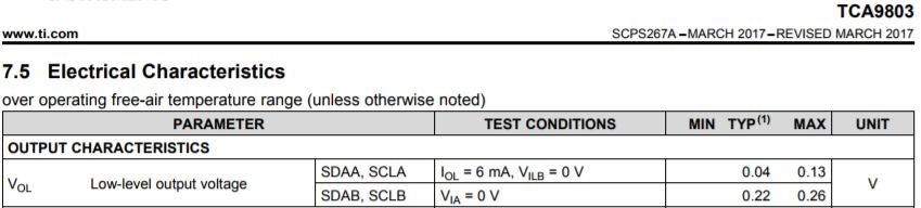

    To add to Bobby's response, we have an I2C buffer that provides a much lower VOL spec than the TCA9517 - take a look at the TCA9803. This device has an improved architecture to eliminate the need for a static voltage offset, which allows the VOL to be much closer to 0V .
    Max VOL of TCA9803 is 0.26V - see electrical characteristics from the datasheet below.
    Kaitlyn
