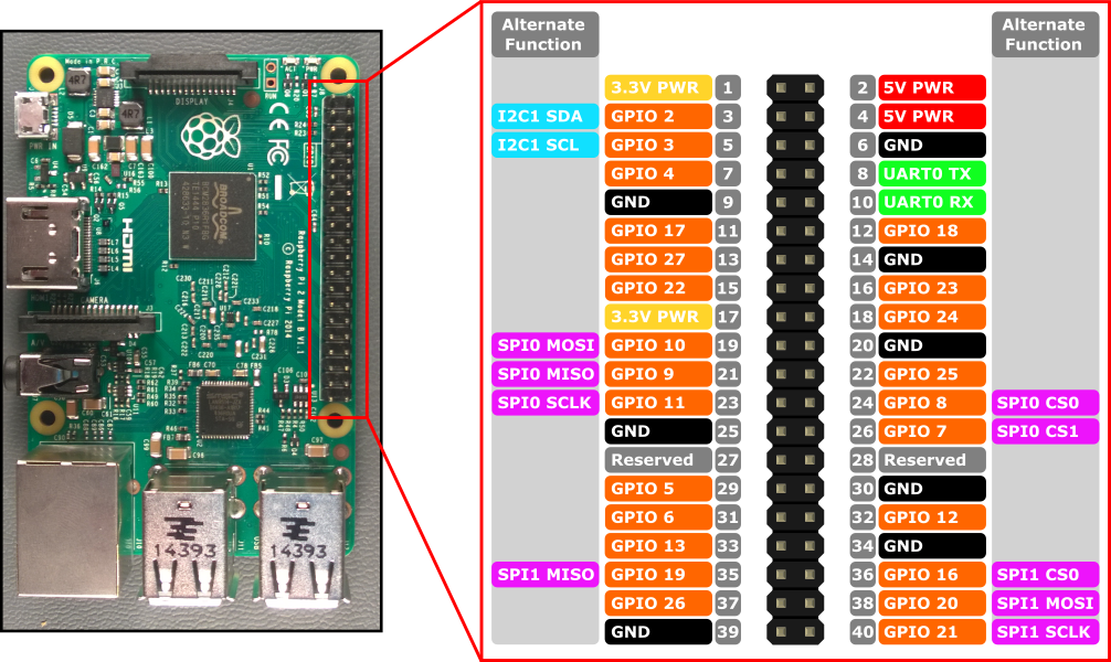

I'm trying to communicate with a raspberry pi 3
input's are driven by 12V and leds are connected to led drives.
The data on SPI connection is weird.
For example if i had 120 as binary on leds i had 126 on spi output.
And if i add 2 126 stays the same.
take away 2 and it rockets down to 80.
I can never predict.
I'm running the SPI on
mode0 (But tried all 4)
8bit datalenght
Pulling the LD input down and up before CE input.
I don't know what i'm doing wrong.

  • SPI0 MISO is connected to pin 23 on SN65HVS885
    SPI0 MOSI is connected to pin 27
    SPI0 SCLK is connected to pin 25
    SPI0 CS0 is connected to pin 24
    Also pin 29 gpio 5 is connected to pin 26
    I don't really have a schematic but i hope this is enough.
    I need this interface for a encoder reader that i'm building, i need to use spi or i2c for input readings.
    (I know encoder only uses only 2 inputs but i'm also using another chip for high speed reading and it gives 8 bit output)
