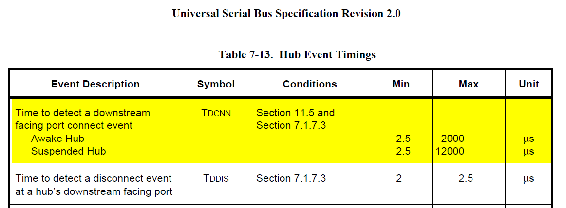

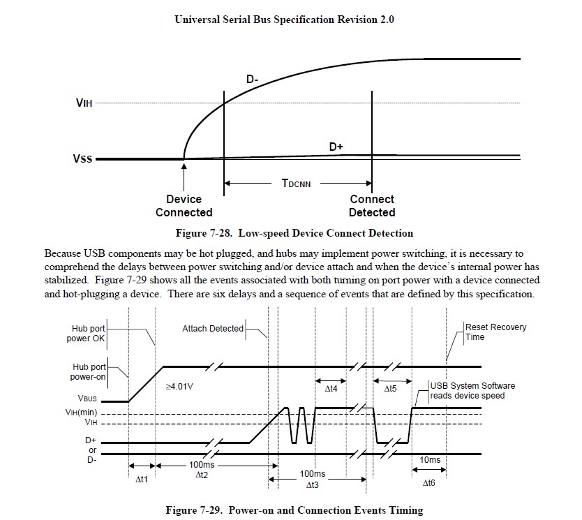

Could you let me know timing diagram of Type-C as below at USB2.0?
I can't find it at USB org.
Thanks.
