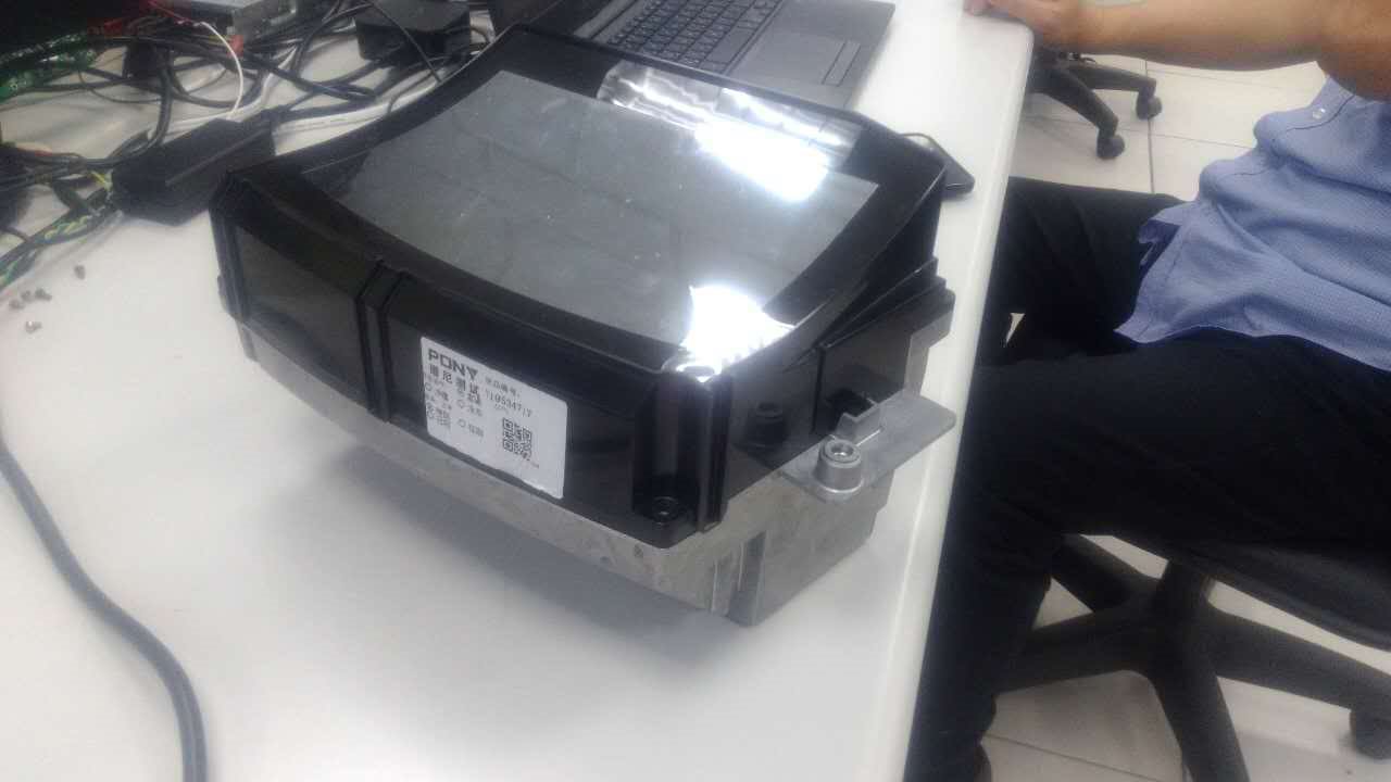

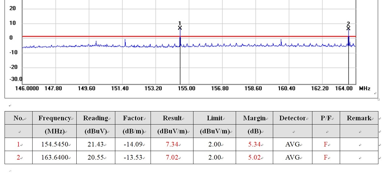

HI Sir
We test EMI of DS90UB925/926 in our system and got fail result
1. May I know DS90UB925/926 EVM EMI test result (with SSCG and without SSCG) ?
2. Beside SSCG function ,do you have any idea how to solve this issue ? due to DS90UB926 system is assigned to use by our end customer
  • Hsiao,
    All FPD-Link(tm) chipsets have been qualified on EMC/EMI test in the 3rd party. To resolve this issue, you should identify the possible clock freq. in your board, such as PCLK freq.? on-board XO? CPU's clocking? etc., also you need check the high speed signal layout, and transmission channels, such as connector, cable shielding performance, etc.
