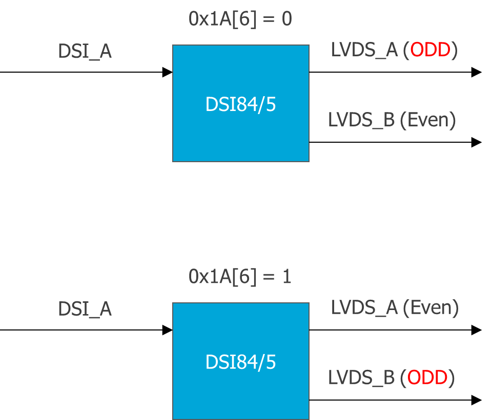

I would like you to confirm whether following my understanding is correct or not.
* When user set 0x1A[6] as shown below, output behavior will become as shown bellow. Is my understanding correct ?
 - DSI_B port is NOT used.
- When 0x1A[6] is set to "0", ODD will be output from LVDS_A and Even will be output from LVDS_B according to DSI_A input.
   And, when 0x1A[6] is set to "1", Even will be output from LVDS_A and ODD will be output from LVDS_B according to DSI_A input.
  In this case, DSI_B can be treated as "Don't care".
