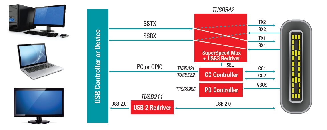

Hi USB Forum team
I know that using USB-type C block-diagram as a blow.
We don't need PD Controller & USB 2 Redriver.
Also, Can we use without CC Controller that TUSB321 & TUSB322? Because, we don't have board size and pressures cost.
What is mean DE_AP(dB), OS_AP(V), EQ_AP(dB) Table.2 on tusb542 datasheet?
Best Regards
Gerald.

  • Hi Gerald,
    The CC controller is needed since the system should be able to perform the detection of the attached device through CC pins, hence, the CC controller is mandatory for a certified final product.
    Regarding DE_AP, OS_AP & EQ_AP, basically, these control signals specify the equalization of the signal integrity (De-Emphasis, Pre-Emphasis and Swing settings) to optimize the link conditions.
