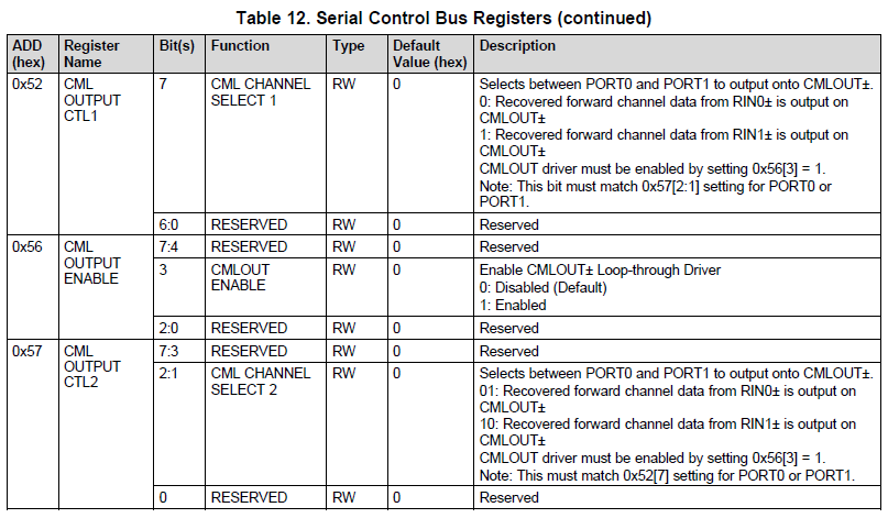

Hi Team,
I believe CMLOUT feature is set by accessing 0x52 and 0x57, 0x56 registers.
Is there any procedure to set these registers?
I would also like to know if the CMLOUT feature can be set anytime.
Yaita / Japan disty
