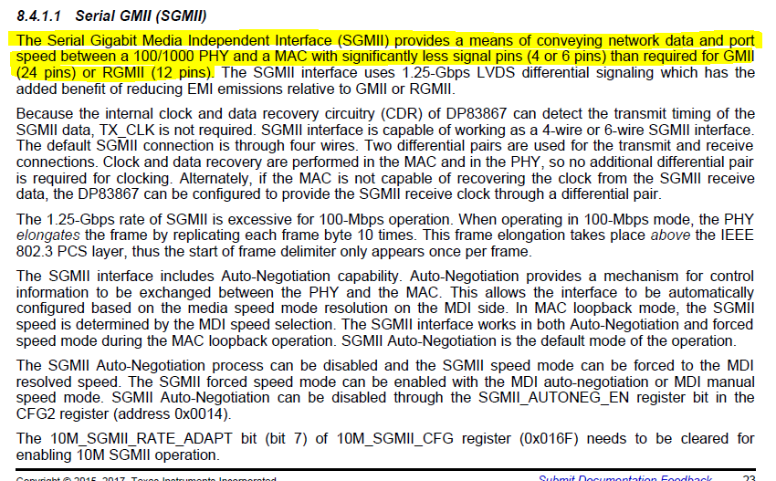

With the TI DP83867 phy chip connected to the SGMII interface,
At speed 100 / 1000M, link up, tx and rx are normal,
In the speed 10M state, link up and tx operation is normal, but rx operation is not normal.
(In the ping operation, the recv increase in the other device is confirmed.)
I have two more questions as below.
1. In the datasheet, only 100/1000 is explained in relation to SGMII function as below. Is it possible to communicate with 10M in sgmii state?
2. Please explain about 10M_SGMII_CFG register. The datasheet contains only the following sentences.
“The 10M_SGMII_RATE_ADAPT bit (bit 7) of 10M_SGMII_CFG register (0x016F) needs to be cleared for enabling 10M SGMII operation.”
