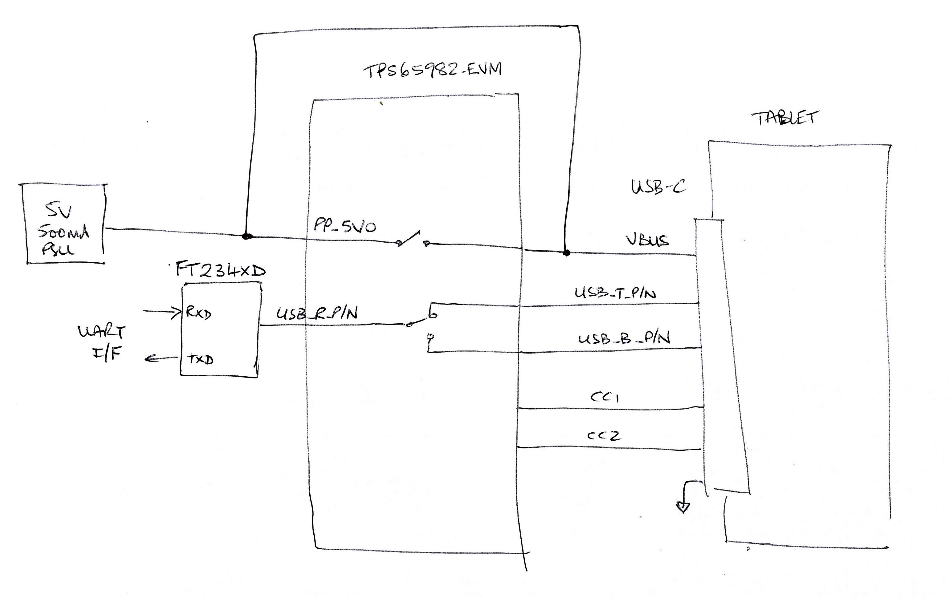

  • I also have the same application requirement which is to attach an FTDI USB-to-UART device (such as the FT232R) as a UFP to a tablet as DFP whilst at the same time charging the tablet @500mA.
    I have setup a TPS65982-EVM board as shown here:
    I have customized the EVM settings using the TPS6598X Application Customisation Tool as best I can. I can get the EVM board to correctly request the power role change to set the EVM as the source and tablet as a sink and can charge the tablet at the 5V 500mA level but the EVM seems to stay as a DFP. In experimenting with customisation settings I can sometimes get both charging and FTDI data connection but not reliably.
    Question for Chuck Branch,
    Can you suggest what the key customisation settings required are to get this to operate correctly and are the VBUS and USB connections I've made in the EVM board look sensible?
    Gerry
  • Gerry,
    The only change that I would make to your diagram is to not short from the 5V VBUS connection from the PSU to the VBUS connection on the Tablet. The TPS65982 is intended to be the power switch and it must be able to interrupt the power supply for your application. In your case, you would configure the '982 as a DFP port that can only supply 5V.
    Please let me know if you have any further questions.
  • Hi Chuck,
    Sorry, I made a silly mistake in the drawing, I meant to show the VBUS connected to the FTDI device like this:
    So what I want to do is configure the '982 as a sourcing UFP for connecting the FTDI device and supplying 5V power to the tablet and the tablet as a sinking DFP. It's the customization settings for achieving this that i seem to be having trouble with. Any guidance on settings would be much appreciated.
    Gerry
  • Gerry,
    If I understand your requirement correctly, you are looking to perform a data role swap on the USB lines. This is possible, but it does not actually change the power role of the port, only the data role of the USB port.
    Is this what you want to do?
    Chuck
  • Hi Chuck,
    For the tablet, we want it to be a DFP (or host in USB2.0 terminology) and the FDTI/TPS65982 to only ever be a UFT (or device). My understanding is that a DFP will normally be a source of power so we would want the TPS65982 to request a power role swap so the tablet is a sink. I hope that makes sense?
    Gerry
  • Gerry,
    How does you FDTI device respond the the roll swap change in power supply? VBUS will be at least partially discharged as part of a roll swap. If your FDTI chip does not reboot fast enough, this could cause the intermittent issues you are describing.
    Chuck
  • Hi Chuck,
    Thanks for those comments. I'll check how the FTDI responds to the VBUS changing over. In the meantime, can you suggest what the key TPS65982 customisation settings should be for the FTDI/TPS65982 to a sourcing UFT?
    Gerry
  • Hi Chuck,
    I have succeeded in customising the TPS65981-EVM to behave as required as defined in the sketch I posted on 1-Dec-2017 i.e. the TPS65981 acts as a device and makes a USB connection the FDTI device and also acts as a 5V source to charge the Tablet via the PP_5V0 power path.
    However, if the tablet battery is fully discharged, I can't find a way to customise the TPS65981 to start charging the tablet, the PP-5V0 power path never gets enabled. Can you suggest how this can be done?
