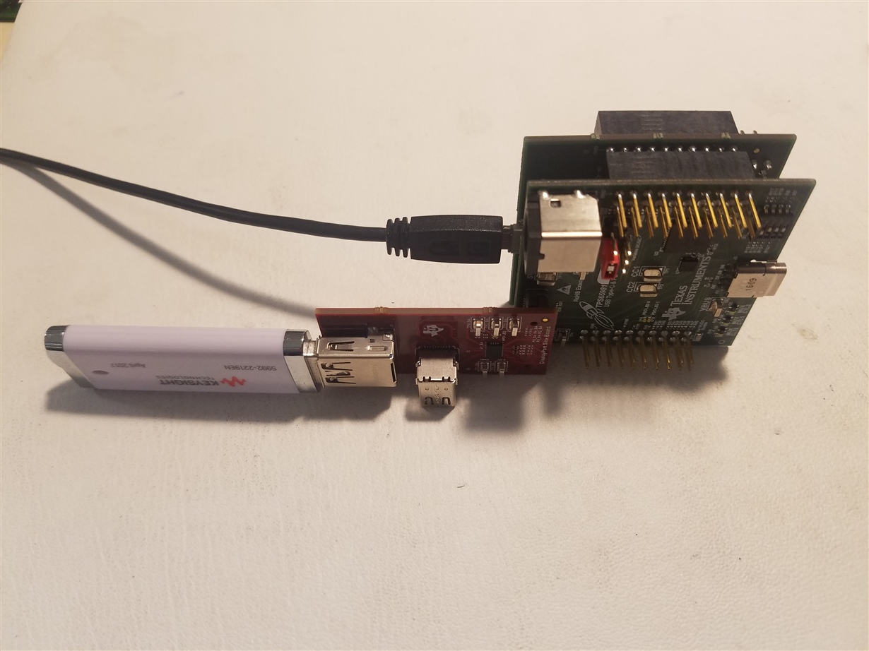

We've put the TPS65981 chip on a board design and are having trouble setting up the board for USB communication through the chip. If in the "Application Customization Tool" we select "Re-Flash EVM Firmware (Recovery)" then the chip is able pass USB through succesfully when the USB Type-C cable is connected in one direction. When we flash the chip with our own .bin file, then USB communication fails.
I've reverted back to a setup using an onmodified TPS65981EVM board with the DP-EXPANSION-EVM board and have the same behavior. On the EVM board, the S1 topmost location connected to R13 (BUSPOWERZ) is set to the left for wake on dead battery, the rest of the locations are set to the right per the User's Guide. On J6, pins 2 and 4 are shunted together so that PP_HV is connected to SYS_PWR. On the expansion board we have a simple USB thumb drive and the USB Type-C connector gets connected to a laptop.

  • Same bad result. tried it on a Dell Precission 7510 laptop; Dell Precission M4800 laptop; and a Dell PC. These were tried with a USB A to USB-C cable. The communication comes up temporarily and then goes away quickly.
    When using the Dell Precission 7510 laptop, I saw this laptop has a USB type-C connector on it. It behaved differently on this port using a USB-C to USB-C cable. The power stayed up, but it had a problem loading the driver. Flipping the connector orientation, it didn't even try to load the driver.

  • Hi David,
    I was able to reproduce your issue using a Type-C to Type-A adapter. The USB EP was enabled so the TPS65981 would send a billboard message to the PC since no alternate mode could be entered. I removed the USB EP in the configuration settings and was able to enumerate the USB flash drive connected to the TPS65981EVM. Please try the following flash image on your side and let me know your results:
    https://e2e.ti.com/cfs-file/__key/communityserver-discussions-components-files/138/TPS65981EVMFullFlashUSBData1.bin
    Thank you,
    Eric
  • Works on my EVM, doesn't work on my own hardware. I'll continue debugging. Thanks. Can you send the .PJT you used?
