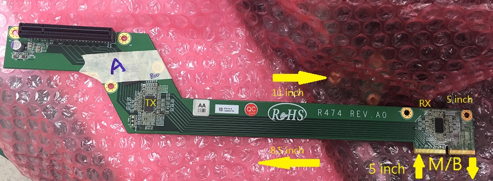

Hi there:
I'm helping customer to debug the DS80PCI810 performance in server's add-in card.
We found sometime the card will not be detected by host.
the attachment is the add-in card PCB real drawing. It use DS80PCI810 *2 as TX/RX
I'd like to check whether the location is OK or not in that distance.
Or we should promote customer us the DS80PCI800 for best performance?
  • Hi Kay,
    The locations look okay.  From the picture I think there are AC coupling capacitors on both Rx/Tx pins at each DS80PCI810 location.  Typically, some of the AC coupling capacitors would be located on the add-in card and motherboard.
    Do you have a schematic of this board?
    Lee
