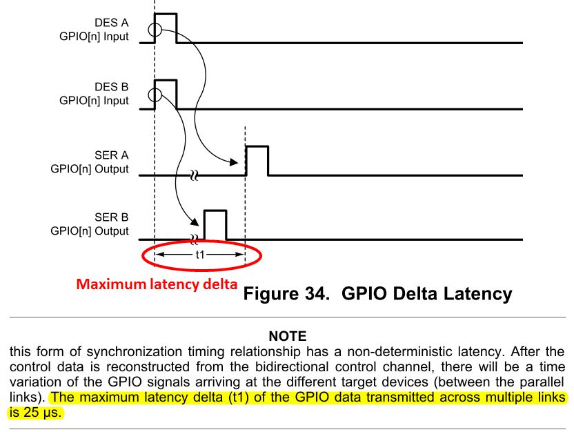

I referred DS90UB914Q-Q1 DS then I could find the maximum delta latency as attached. Then the customer would like to know such value for DS90UB954-Q1. So please let me ask following question.
  1. I found the typical latency in DS90UB954-Q1 DS table 9 but I believe that this does not mean delta latency. Is my understanding correct?
  2. Please let us know the maximum value if this latency in table 9 means delta latency.
Your kind response will be appreciated.
