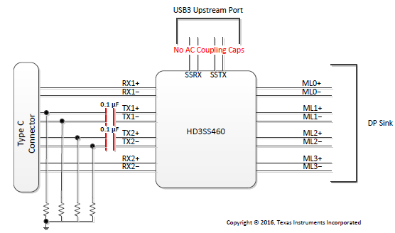

Hi Expert,
My customer is designing an application with HD3SS460 and they'd like to know whether ac caps are required on TXx+ and TXx- if MLx+ and MLx-  have ac caps
placed already.
The picture below shows the possible cases of their application:
Thank you!
