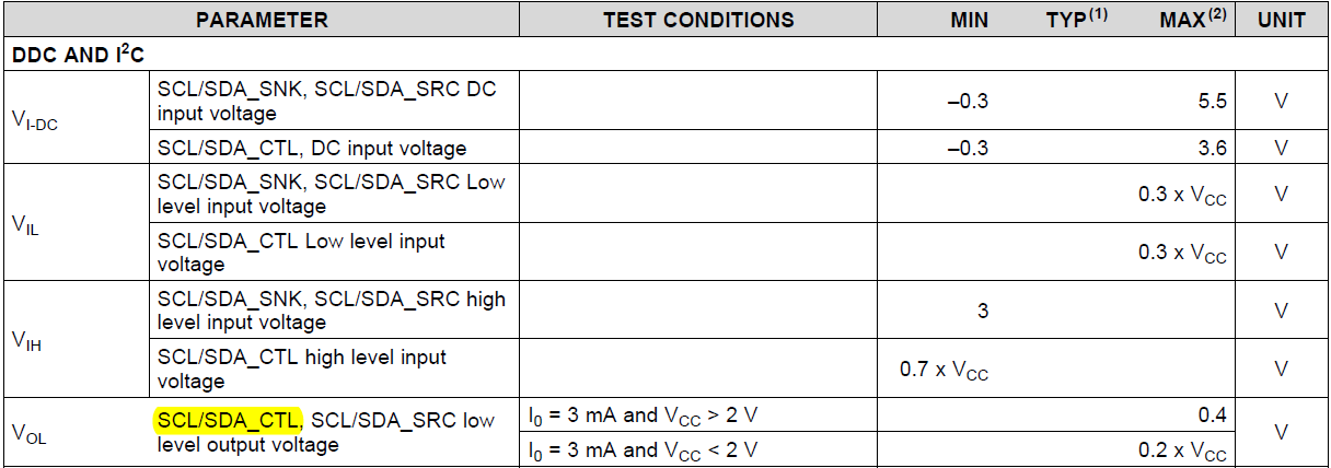

We guess that “SCL/SDA_CTL” is a mistake because “SCL/SDA_CTL” is input only.
Therefore, we understand that “SCL/SDA_SNK” is correct.

My understanding is as follows.
Is my understanding correct?
Incorrect : SCL/SDA_CTL, SCL/SDA_SRC low level output voltage
Correct : SDA_CTL, SCL/SDA_SNK, SCL/SDA_SRC low level output voltage
