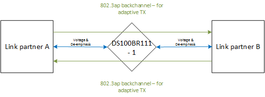

Please see the diagram below:
When the endpoints are configuring their transmit and receive equalizer coefficients, will the DS100BR111 also monitor the link and modify its equalizer coefficients as seen in the first possibility identified in the diagram above.
For example, say Endpoint B says that it requires a higher transmit from the link, will DS100 b increase its transmit strength from this request, or will that request propagate down to Endpoint A and Endpoint A will increase its transmit coefficients (conceptually seen as the second possibility identified in the diagram above - as if the repeaters were not present)?

    The DS100BR111 is a repeater that only provides CTLE EQ and transmit VOD gain and de-emphasis. The setting is programmed manually and does not actively change while the host and end-point undergo auto-negotiation and link-training. From the perspective of the host and end-point, the DS100BR111 is invisible and is meant only as a way to improve signal integrity when the link is running at speed.
    I am unable to see the diagram you posted, but I think I understand the gist of your question. When the endpoints negotiate their transmit and receive equalizer coefficients, they are requesting updates from the corresponding endpoint, not the DS100BR111. To the endpoints, the DS100BR111 are transparent and should not affect the ability for the endpoints to optimize their coefficients.

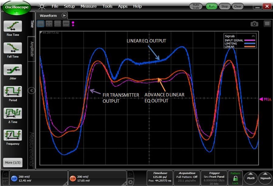

    The scenario you described is valid if the redriver's Tx driver is a limiting driver, where the Tx parameters (such as precursor and postcursor) are not passed through after the redriver. In this case, link partner B will not be able to tell any difference from when changes are made to link partner A's transmit output coefficients.
    To preserve the incoming precursor and postcursor through the redriver, we recommend operating the DS100BR111 in 10G-KR mode. By doing this, the DS100BR111 driver operates in a more linear mode. By doing this, the precursor and postcursor can be maintained through the DS100BR111 so that the link partner B can see the difference in the signal it receives from link partner A.

    There is a possibility that if if there is a very short channel before the repeater, there may be an over-EQ scenario where the residual boost from the smallest CTLE setting. I'm guessing that this is the saturation you are referring to. However, given a long output channel from the repeater and the linear operation of the DS100BR111,  the over-EQ applied by the repeater's Rx will act indirectly to help the transmit EQ alongside the repeater's de-emphasis. However, as you mentioned, in an ideal scenario the DS100BR111 would have similar channel loss on either side.
    If linearity for link training is a key concern, alongside placing the repeater in an unbalanced system, I suggest taking a look at our "advanced linear" repeater, the DS125BR111. This device is pin-compatible with the DS100BR111 and has a higher degree of flexibility regarding where it can be placed due to its improved linearity compared to the DS100BR111.
