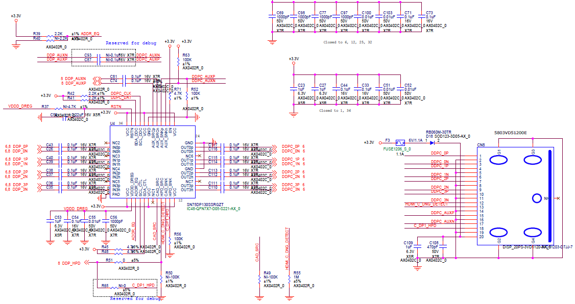

I have a question about how to improve pre-emphasis over issue at SN75DP130?
The schematics as below and attachment. And layout trace as followings.
If you have other comments, please help to share with me. Thanks for your great support.
Docking Board Mother Board
mils 0.1 uf mils Pin Name Pin Name mils 0.1 uf mils mils 0 ohm mils Pin Name
DP connect 109.1 C117 88.43 OUT0_p DP Redriver:
SN75DP130SSRGZT

  • Hello Wang
    The pre-emphasis can be adjusted by the I2C interface and a good test to figure out a good level is an eye diagram. It depends on the application, position, traces, cables, etc.
    I let you some comments about your schematic.
    - Pull-ups resistors for SCL/SDA_CTL have to be 2K but if 4.7K are required by SMBus, is ok.
    - In case of VDDD_REG is only necessary one 1uF cap to GND.
    - But in case of Vcc is necessary one 1.uF on each power pin and one bulky cap to DP130.
    - In case of ADDR pull-up/down resistors have to be of 4.7K
    Francisco
