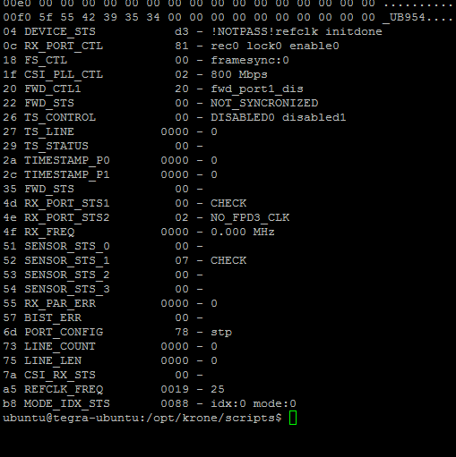

  • Hi Mandeep,
    after switching the serializer to STP mode I get the following deserializer register settings:

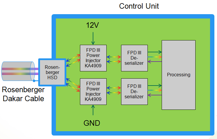

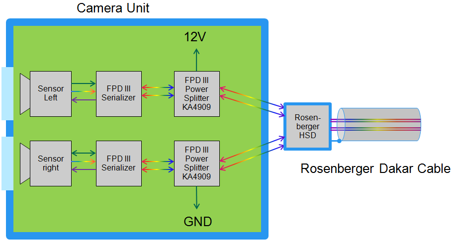

    to understand our requirements I'll try to explain the system architecture.
    The system consists of a stereo camera unit and a control unit. The stereo camera unit contains 2 sensors each connected to one serializer. The sensor data is transmitted to the control unit via a single shielded cable consisting of 2 twisted pairs using 4-pin rosenberger connectors. The control unit contains 2 deserializers, each of those receiving data from 1 serializer.
    The camera unit has to be powered remotely via the single fpd link cable. What we do is, we inject 12V power to one twisted pair at RIN of deserializer 1 and GND to the other twisted pair at deserializer 2 (see block diagrams below).
    As I understand your message, power over STP is not supported at all. So is there any way to transfer power and data via the same single cable?
    Rolf
  • Hi Rolf,
    By not supported, I meant to say we have not validated or tested the part for POC with STP. If I understood correctly, you are provding power to the serializer through both RIN+ and RIN- on one twisted pair and Ground on the other? If so, this would be the correct configuration. Issues occur if only RIN+ is being provided power and the RIN- is ground.

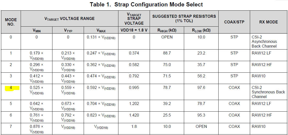

    I noticed the DS90UB954-Q1 register 0xB8 = 0x88, this suggests that you have the Deserializer set-up to accept an external clock but my understanding is that you are providing a 25MHz reference clock. Could you try Mode 4? CSI-2 Synchronous Back Channel and provide the register settings again.
    Reading through the earlier post again, I noticed that you are programming the serializer to put into STP. Typically, the hardware changes alone are sufficient to place the part into STP mode. Would you be able to provide the register settings of the DS90UB953-Q1 as well?
    Mandeep

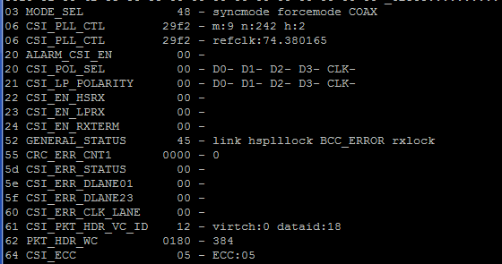

  • Hi Mandeep,
    I changed the strap resistors  to mode 4, but there is no change.
    I get the following register settings:
    Serializer DS90UB953
    Deserializer DS90UB954
    The Serializer remains in COAX mode. As soon as I configure the serializer to STP mode (setting register 0x03 to 0x80), it is no longer accessible via I2C.
    Rolf
  • Hi Rolf,
    So you’re still not able to receive the data from the sensors? The registers are showing that you are receiving a valid LOCK.
    Register 0x03 will show COAX because you are in MODE 4; however, you can still transfer data in STP. Could you leave register 0x03 as default and check if you are receiving data?

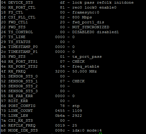

  • Hi Mandeep,
    indeed I can receive data from the serializer with the changed settings. But I get the same behavior as with using COAX-Mode. With 2Gbps it is working with 15m cable length. With 4Gbps it is only working with a short cable (< 5m).
    The current settings are as follows:

    b8 MODE_IDX_STS       008c - idx:0 mode:4
    How can I check if it's really a STP connection and what is the difference between COAX and STP concerning signal type or level? Can I detect the mode by measuring the signal with an oscilloscope?
    Rolf
