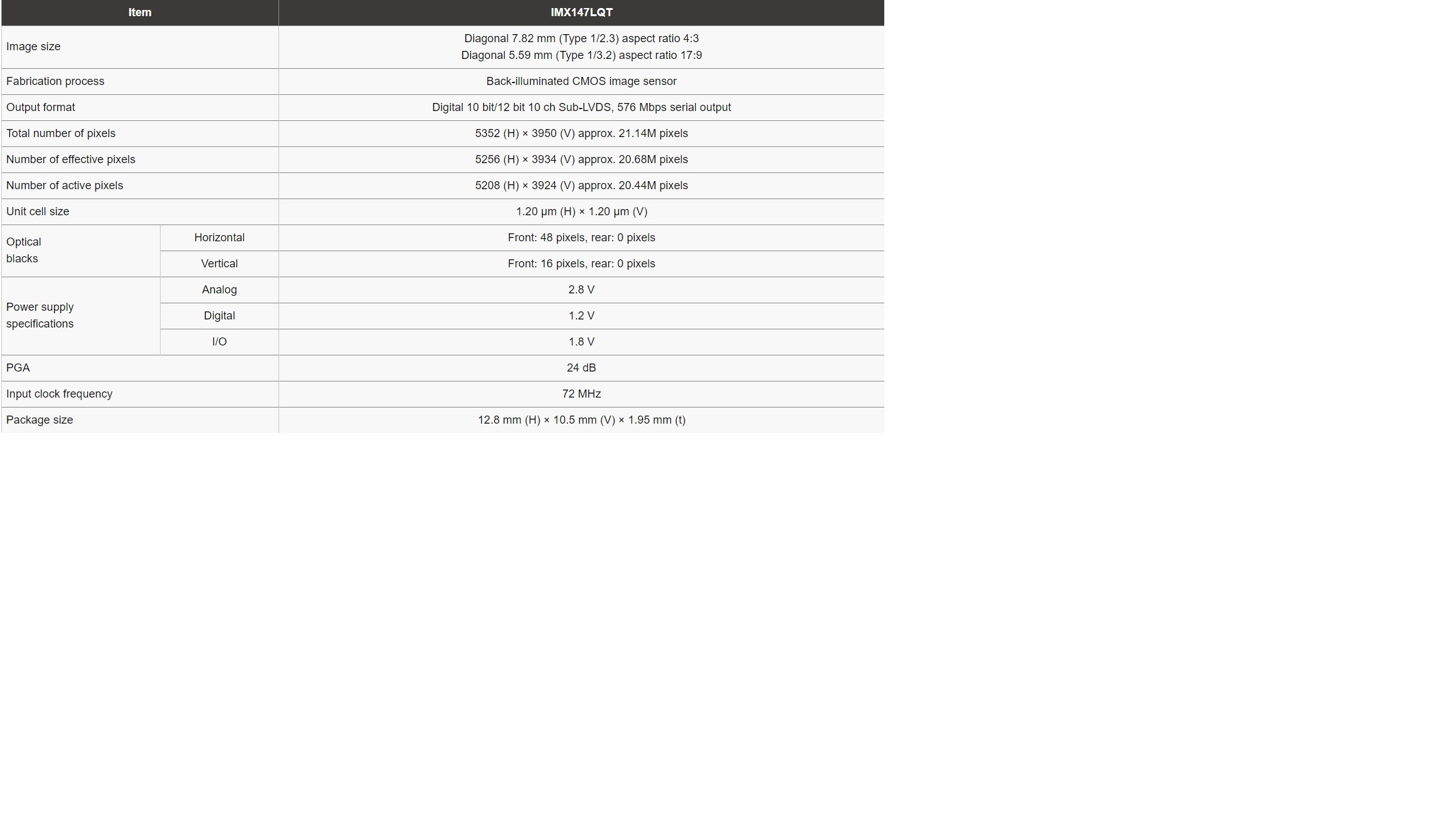

Part Number: SN65LVDS324
Dear Sir,
Does SN65LVDS324 input can support Sony_ IMX147 sub-LVDS output formate ?
Thanks!
Steven
