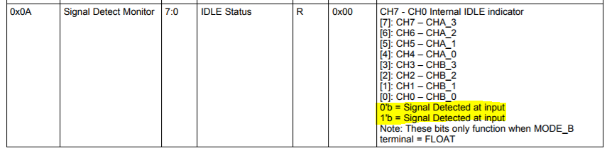

DS125BR401A: Clarification question about register at address 0x0A
Part Number: DS125BR401A
I was trouble shooting some detection issues for a customer and noticed this in the DS125BR401A datasheet on page 27:
 Could you clarify which bit value means that the Signal was detected at the input?
Thank you so much, apologies for the late post.
