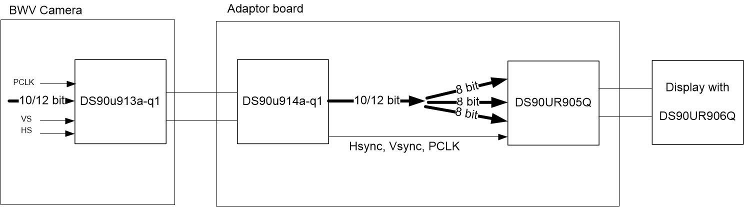

I have a camera that outputs FPD III (DS90ub913), and I need to interface a display that contains the DS90UR906Q-Q1.
(Currently the ds90ub913 is connected to ds90ub914).
I suppose I can not connect them (913 to 906) directly. could I?!
if not, I was thinking to add an adaptor board in between.
Does that should work?
