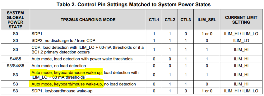

Hi Team
          We setting CDP on S0 and DCP auto on S3/45 , We can use keyboard/mouse wake up sysrtrm ( S3 --> S0 )
          BTW
          We setting DCP shorted mode ( CTL1/2/3 ==> 1 / 0 / 0 ) , We can not wakeup from keyboard/mouse ,  ( S3 --> S0 )
          Could you help check DCP shorted moed can not suppor wakeup function?
                                                                                                                        Thank you so much
