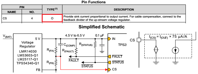

[ TPS2549-Q1 ] CS Pin, Output or Input?
The pin functions tables says that CS pin is output pin.
However, if we see the schematics, this seems input pin.
i.e. it obtains the current from feedback network of DCDC.
I know that, from the pin function perspective, this pin is supposed to tell the load current to DCDCs, so this can be considered as output pin...
Do you have any ideas?
