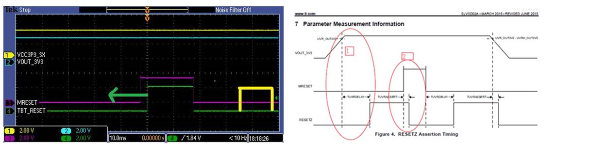

For the TPS65982 datasheet, the waveform is as figure 4.
However, cussotmer's current resetz and mresetz behavior is quite different than datasheet.
From the spec, RESETZ seems to be asserted only follow the rising of MREST, however it’s not. It seems to be aligned w/ MREST on both rising/falling.
We assumed this resetz pin here should be shifted and modified its behavior or this spec is not possible to be complied with.

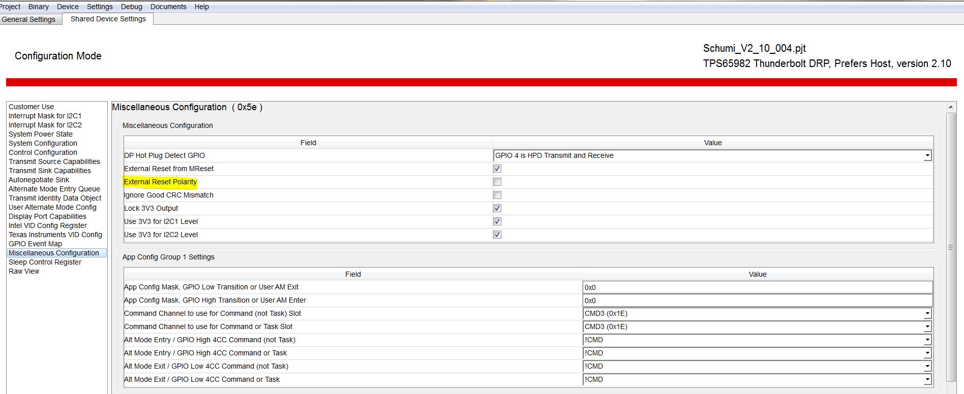

I attached the .pjt file. If the datasheet waveform is possible, please kindly advise how to set the setting.
Schumi_V2_10_004.pjt
